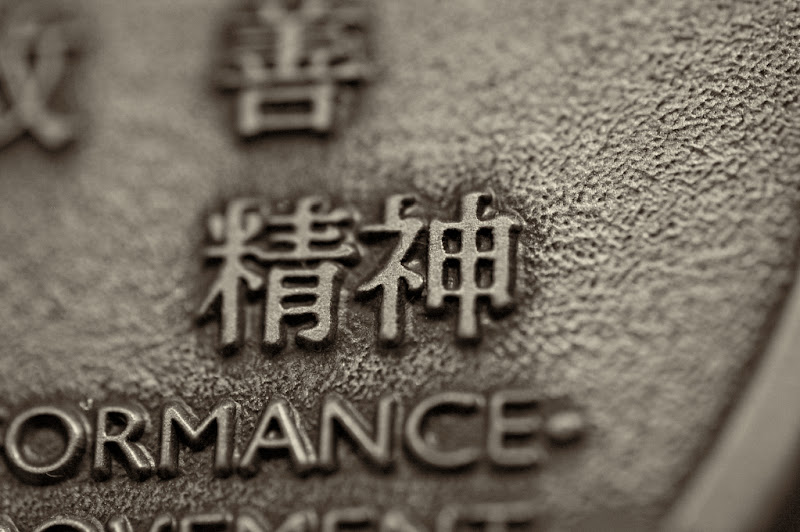

I'm really new to this, having done primarily P&S with low-res Olympus cameras in the past. On occasion I do closeup and detail photos such as this,
and I'm wanting to get a lens/flash setup for my new K100D that will do this kind of shot, or even greater magnification. My current lens is an SMC DA 18-55 (the kit lens) and I have a Tamron 28-300 on the way, as well as a Sigma 530DG super. I think with the addition of a really good close-up lens my emerging LBA will be satisfied.
I don't exactly know what to search for on the forum, so suggestions and advice on that would also be appreciated.

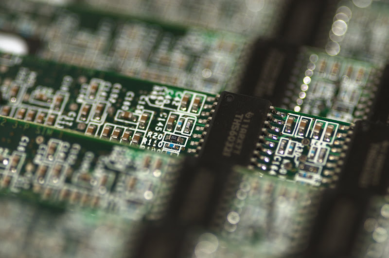

I can vouch for the non-DG versions I have bolded in red above. Great close focus lenses. Here are two hand-held shots i took with my K100DS:
50mm 2.8:
105mm 2.8:
I have since traded the 50mm 2.8 Macro lens for a FA50 f/1.4 lens. The 105mm is a better working length for the type of shooting I do.

So what would be suggested if I want working distances (from lens to subject/object) no closer than 15cm or so and the ability to resolve features as fine as .01-.02mm? I also need DOF of at least 10-20mm because I may not be able to get the camera axis normal to the surface being photographed.
For reference, IIRC the picture I posted above was taken with an Olympus C-720 P&S, ~3MP.

Like it was said earlier in the thread: For that kind of work you will need a true Macro lens or adapter. The distances you are talking about are referencing from the front of the lens to the subject? Most distances are measured from the sensor to the subject. From your post above this i what I think you are trying to do:
This is straight conversion from PEF to JPEG and resized for web, no cropping. I used my 105mm and the front of the lens was about 4 or 5 inches from the Aussie nickel (didn't have a dime on me but they are roughly the same size). From the back of the camera to the subject was about a foot or so. There are a lot of excellent Macro shooters here who might be able to tell you off the top of their heads which lens to buy based on your working distance requirements.
