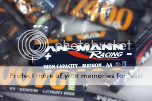

read up on what is Ni-MH.
so far most of the users i know use eneloop batteries since they cant be bothered to practice recharging batteries before a shoot. such batteries retain their charge longer but i do find the flash is kinda slower to recycle compared to using regular rechargeable batteries. Still faster then most AA anyway.
however if you can, try these out..
