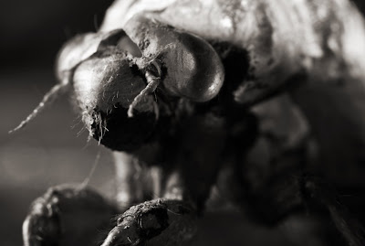

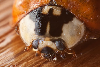

Here's a few I have taken with my smc 50mm f/1.4 and some vivitar auto extension tubes.

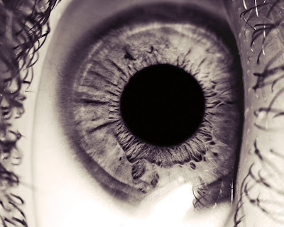

no swaet, lots of folks do the same thing w/o thinking twice. It's more about bandwidth than anything...btw here is the shot I took, not edited but you will get the idea...I evenutally phart'd with Macro Fractalius it into the send image:
Phart'd version:
Click here to see the evolution of the shot
anyway to help with your question...my eye shots were self done holding the lense in front of my eye...just try that one sometime with a 3lb Simga 180mm macro!! hahaha!! But the trick for getting the lense aligned is to simply look into the lense for the refelection of your eye as well as stare straight into the center of the lense....and yup, the flash will blind ya for a while!! hehehehe....
