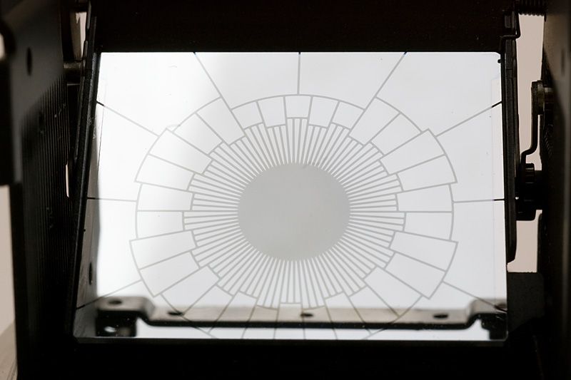

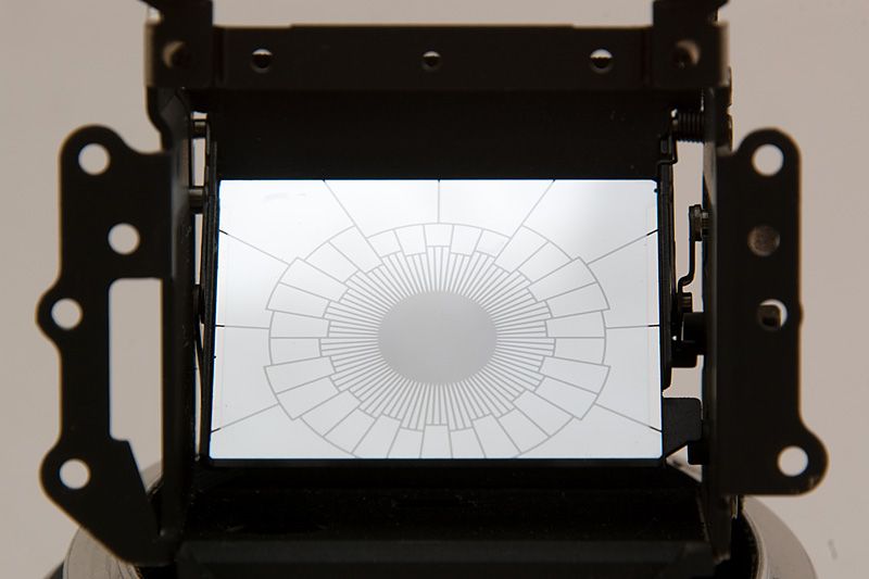

It is a little confusing at first, because at times it seems like the opposite of how lenses work in non-macro situations. Here are some example photos that show some of what I'm explaining. In this first photo, I used a Tamron 28-300mm "macro" superzoom. I set it to 300mm and got as close as I could to the subject, the mirror from a Pentax SF1 film camera. I used f16 for decent depth of field.
You may think "300mm, that sounds like everything I'd ever need". But 300mm in this case is not a useful measure of macro ability. Magnification is everything. The next photo is the same subject and f-stop, as close as I could get the lens to focus:

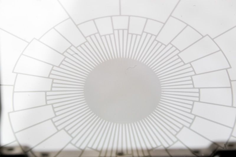

For that photo, I used a Pentax-M 50mm f4 Macro, capable of 1:2 or half lifesize magnification. Here's another photo even closer:
That's with a Pentax-FA 35mm lens and a 25mm extension tube. I'm not sure what the magnification ratio works out to be. Working distance was almost touching the front element of the lens.
