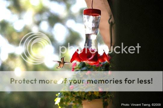

Here are two approaches to the conditions - I think my situation here may be similar in that there was a lot of bright spots in the background where the K100D would ahev underexposed for the overall shot.
1) Manual exposure - set by trial and error until I got the compromise I wanted - and it was a compromise between not blowing all the scene out and capturing enough detail ion the subject - in this case it probably would have been foolish for me to try and use spot metering.....
I set the exposure to get the red "petals" of the water-feeder about right - nevertheless the overall shot would be considered underexposed - I just brought it up in my photo editor.
light was relatively steady -
overall shot -
Cropped shot
(EXIF attached - caveat PhotoBucket can mysteriously drop metadata) -
K100D ISO800, Manual, f/5.6, 1/800, pre-focused manual.
2) Av (Aperture Priority) with Patterned metering
On another day when the light was changing, so I used Av (near max aperture to get near max shutter speed for the conditions) and Patterned metering - again the overall shot would be considered underexposed - as I would expect from Pentax K100D - so I brought it up in my photo editor -
overall shot -
Cropped (EXIF attached - PhotoBucket caveat)
K100D ISO800, Av, Patterned, f/6.3, 1/800, pre-focused manual
