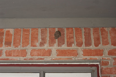

Much of the time, it doesn't make a huge difference what metering mode the camera is using. If the dynamic range of the scene is fairly "normal"—no extremes of both bright AND dark—then all three modes will meter the scene with pretty similar, sometimes identical, results. Consider the following examples. I'm shooting a mud dauber's nest on my front porch. Behind me, the sun is shining brightly in the front yard, but the porch is entirely shaded and the dynamic range of the scene is pretty limited. Changing the metering mode didn't produce a change in the recommended settings for exposure:
Now, I simply turn around and face the front yard. I'm shooting with my feet in the same spot, just facing the other direction, toward the bright day sky. I focus and meter on a tree in my yard. NOW there's a significant contrast between the bright sky and the darker tree, and the choice of metering mode makes a big difference.

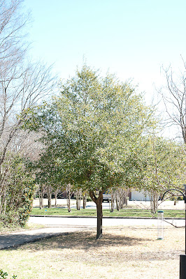

This first shot was taken with matrix metering:
The overall result is pretty good. The sky in particular is a deep blue—bluer than in reality, but it's attractive.
Now, spot metering:
Whoa! Much of the sky is now completely blown out, and even the tree seems overexposed, because it is. The tree is dark. It's supposed to BE dark. But the meter wants to make it middle gray, so it overexposes it. This is clearly no good.
Here's center-weighted metering:
Interestingly, in this scene, center-weighted metering = spot metering, because the center-weighted area is all tree, so expanding the metered area doesn't really make a difference. So this stinks, too.
Of the three shots so far, it's clear that the first one—with matrix metering—is the best right out of the camera, and the one that will most likely be able to be improved in post. The blown highlights in the second and third photos can't be recovered. (I didn't try and some improvement might be possible. But not enough.)

Which is what I did when I took the last shot of the boring tree in my boring front yard: I cut the shutter speed in half (from 1/750th sec to 1/350th sec). Here's the result:
This is the best of the four exposures of the tree. NOTE CAREFULLY that it doesn't LOOK as good right out of the camera as the first one. It looks a bit washed out. That's okay. For one thing, it's a more accurate representation of what I actually saw. Even more important, there are no blown significant highlights here and the exposure is pushed just about to the right edge of the histogram, where I want my raw captures to be. This shot can be processed more effectively than the first one.
