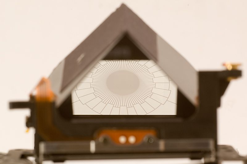

Pentaprism viewfinders typically have a larger and/or brighter image than pentamirrors. My camera has a pentaprism and is rated at 0.95x magnification, and a nearly identical model with the pentamirror has 0.85x magnification. The mirror design can't transmit light as efficiently so the designers often reduce magnification to maintain similar brightness. I've used the nearly identical model and if I did not know to look for a difference, I probably would not see it.
The prism adds weight too. Here is the prism from a Pentax SF1 film camera, bigger because the film format is larger:
