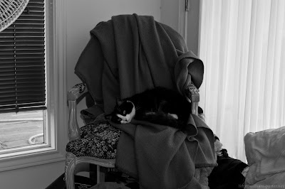

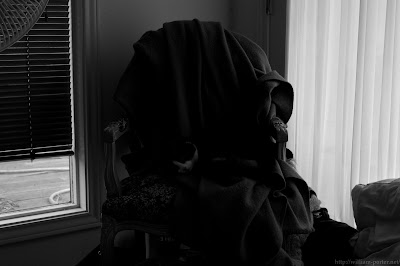

Here's a simple example. My daughter's kitten is sitting in a chair in a bedroom. I want to photograph the kitty, but I don't want the windows to be completely blown out (way overexposed). So first, I calculate a correct exposure for the windows, especially the one on the right, with the curtain.
Yeah, I know. You can't even see the cat in there. That's okay. Look at the curtains on the right, or through the blinds on the left out to the deck. Those areas are correctly exposed. I'm in M mode on the camera. Settings are 1/180th sec, f/6.7 and ISO 800.

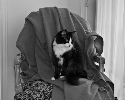

NOW I turn on the flash, in P-TTL mode. I bounced the flash off a white wall behind me and to the right, in an effort to match the direction of the flash with the light from the window on the right. The first shot that I took was not too bad:
This photo has not been improved in post-processing, but it could be quite easily. It would be easy in Lightroom to use the adjustment brush to lighten up the chair and the kitten a little, and the result would be a satisfactory shot.
However, I decided that I wanted to make the cat a little brighter still. In retrospect, I wish I had left the shutter speed at 1/180th sec and opened up the aperture instead; but what I did was the opposite—I left the aperture at f/6.7 and slowed the shutter down to to 1/90th sec. Here's the result:
This shot has obviously been given a little post-processing and has been cropped.
