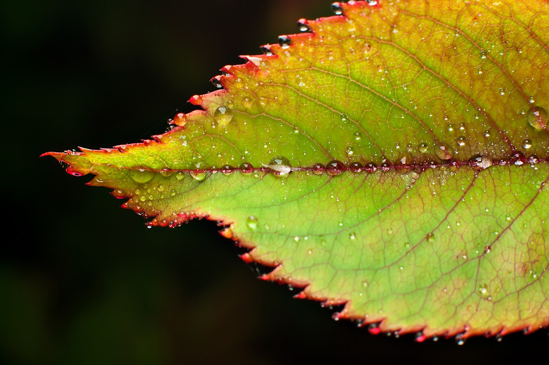

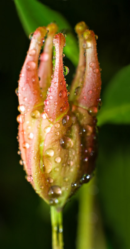

Don't be too hasty in deciding not to use extension tubes. I have an old smc 50mm f/1.4 from KEH for $60 in BGN quality and some vivitar auto extension tubes (no idea what the auto is for) for another $50. For $110, they can give some pro results.
I set the aperture manually on the lens to f/11 or so. Shutter is around 1/180th to prevent subject/camera movement. ISO depends on lighting, usually ISO 200 will do. With a flash diffuser for the onboard flash that reaches over the lens, you can get great soft light.

Wow... these are really nice! Thanks for sharing.

I used the built in pop up flash is all but the 2nd one of those shots. I have a DIY flash diffuser that extends past the front of the lens. That way, the flash shoots forward, then gets diffused onto the subject in front of the lens, below the diffuser material.
