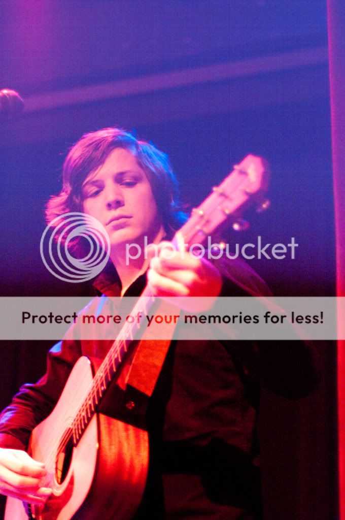

So i have had a K20D for a few years and its tought me everyting I know. Recently while shooting a buddies concert the images started looking a little strange. The left side of every image is purple and also has a line through it. Its the same with every SD card so I figure the sensor is toast.
here are a couple sample images:
ISO 100
ISO 3200
ISO 1600 over editing to show the issue
so what do you guys think? I have since moved on and am now using a KX which I love. So I am looking to sell the K20D...I have a few batterys a couple chargers and a pentax grip for it.
-Nigel

If you look closely at the first two images that you supplied, you will notice a horizontal line running most of the the way across them just a little above the halfway point of the image. I have had two sensors do this on my K20 and am told that this is one of the hallmarks of a failed sensor. Fortunately for me, the camera was still covered by the extended warranty so all it cost me was one way shipping to C.R.I.S. in Arizona and some time. I don't know what the actual cost of the repair would be, but it might well be worth asking them on line before you make a decision one way or the other, I'm pretty sure that you can get a free quote on the repair pretty easily.

Just for the sake of comparison, I use this site to estimate some repair costs.
I pulled up the K20D, and selected "Image Sensor Service" - the detailed information pop-up says:
Choose this repair if you are having any of the following symptoms
  • Horizontal/vertical lines in the image
  • Pictures show discoloration (purple/pink/green)
  • Error "OX58"
Price comes up with $303.00
