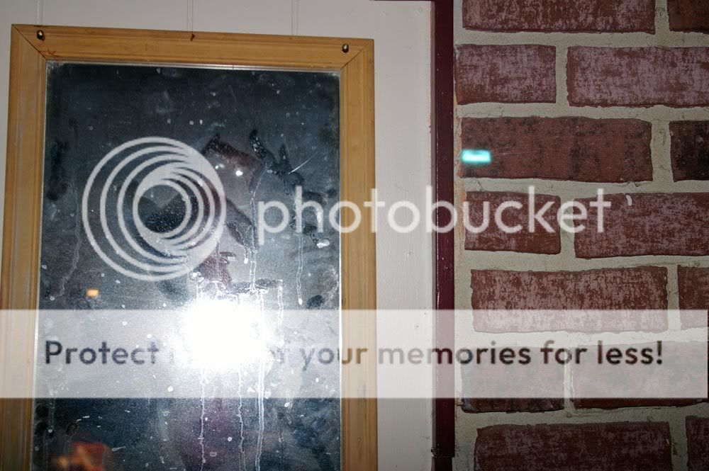

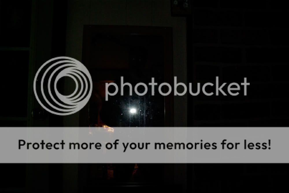

Another K10 problem :(
my camera or flash?
here are 2 pictures of my wifes k100 and my k10 firing the flash the pop up on camera flash in a mirror. both are auto modes.
both fire, but the k100 seems to fire as fast as the shutter. the k10 sounds like it has a very slight delay
all batteries fully charged as well
pardon the dirt
K10
K100
huge difference! not only this, but my sigma 500 super works better on the k100 then my k10. flash zoom works with her camera, not mine.
K10, flash, or both?
please help!!
01-24-2007, 08:52 PM   #2
Location: UK
Posts: 643
is it fireing to late or just to low pwered..?? in a mirror either might produce the same effect..
trog
01-24-2007, 09:11 PM   #3
slip's Avatar
Join Date: Oct 2006
Location: 2 hours north of toronto ontario canada
Posts: 3,529
QuoteOriginally posted by trog100 Quote
trog
Hi and thanks for responding
fireing too late as in the shutter? it seems like when the shutter opens it catches the tail end of the flash.
I don't think it is low powered.... I the flash set at normal... program mode automatic.
seems that the k10 is having problems with the sigma 500 super as well.... the flash zoom function doesn't work and at this point the k10 isn't firing the 500 super either.
everything works well with the K100 though
any other ideas?
this is really bothering me, especially not knowing if it is the flash(s) or the K10
thanks

01-24-2007, 10:32 PM   #4
jfdavis58's Avatar
Location: 13 S 0357397-3884316
Posts: 876
You're aware that both are functioning in P-TTL mode: a preflash that you can see in the viewfinder before the mirror rises. This sets the exposure parameters. Then a main flash when the mirror rises and the shutter opens.
I have a K100, it seems slower than any of our K10s. The flash 'pair' is distinctive and clearly has a break on the K100. It's much faster on the K10; seems like it almost overlaps. This double flash take a considerable amount of adjustment on the part of the operator-it's much different from normal TTL.
Grab up some small knick-nacks or the kids toy soldiers or blocks or even several stuffed animals. Put them on a table top and practice. A remote release and a tripod will help you see the flash as you can compose and focus then move to the side and watch. The K10 AF/AE sensors are big and very sensitive; keep this in mind.
The mirror thing doesn't work too well, especially when it's dusty--yes we know about dust, much of the spring in NM our rain is blowing dust not water.
Let us know how things work out as you figure-out if it's just a new situation or an actual problem.

01-25-2007, 06:21 AM   #9
Location: UK
Posts: 643
"so the K100 doesn't have P-TTL?"
it does have P-TTL..
this might seem a silly question but does your onboard flash work correctly when u are not pointing at mirrors.. ??
plus whilst knowing the sigma flash works okay with a k100 (i have the standard version) i am not sure it does with the k10.. someone that has one should be able conform this thow..
i think u have a problem (fault) with your k10 to be honest..
trog
01-25-2007, 07:27 AM   #10
jfdavis58's Avatar
Posts: 876
Trog got it right-PTTL on BOTH.
Randy, I think you might be a little tightly wrapped about this issue-as a fellow forum user and (believe this or not) a friend, take a step back, center yourself, have a cool drink. Believe me when I say this very same thing gave me a headache and much anxiety too.
I think you are between chip evolutions with the Sigma flash. Sigma doesn't know the mind of Pentax; they are re-engineering to get the flash function. I think they might be 3rd or 4th evolution on the K100 mechanism (most functions mapped and copied) and only 1st or 2nd evolution on the K10 functionality (basic functionality and one or two extras are working) . And they had to marry both functionalities in the same flash---all very complicated stuff.
If you had the Sigma flash re-chipped or not doesn't matter. They have two timelines which are at different evolutions and all the problems have not been addressed. I think your mirror shot identifies and accentuates the situation. The reality is you may need to send the flash back to sigma in a couple months to have it re-re-chipped.
I wouldn't compare functionality as you have done-it's a chase your own tail scenario. Work out how the flash works with one camera, then what it does with the other; but don't compare--especially at intermediate steps in the process; they are not likely to match well anyway.
There is a lot of hysteria with the release of the K10-it's complicated and has a steep learning curve. It's different from older technology in several significant ways-the flash is a big one. Try my simple step by step, plodding, way of set one thing, shoot, evaluate, make a small change and repeat. I've learned a lot-some of it is wonderful, some stuff gives me pause.

01-25-2007, 12:36 PM   #13
Location: UK
Posts: 643
i have noted that at times the sigma flash dosnt work on my k100.. i am reasonably certain its connected with the sequence things are connected up.. whether camera or flash is switched on first for example.. there are several combinations.. some appear to cause the camera and flash not to communicate properly with each other..
i am not sure which combination works as regards switching things on or connecting up but i am sure some cause the camera not to see the flash or the other way around..
the flash zoom is a good way to make sure the two things are talking to each properly i think.. if the flash zoom dosnt work they are not talking..
trog
