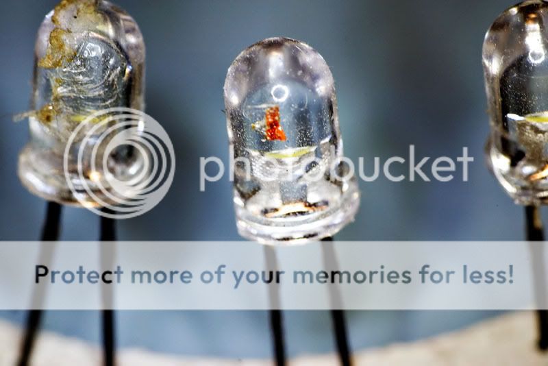

i have a DIY LED ring light. it's composed of 24, 20,000mcd LEDs. it provides plenty of light but i still think off camera flash gives a better image, more of a 3D image. here's a pic of it with a DIY reversing ring and another DIY ring for attaching accessories to the rear of the reversed lens. this is really quite a project.
as you can see here there is a lot of delicate soldering to be done. i know the finished product is not very pretty but it was results i wanted..

it depends on what you want. personally, i don't like the final image, it's too flat. off camera flash gives a lot more depth to the image. here's a few taken with the LEDs. ck the exif, it should be in there.
i just shot these to give a newer idea of the end product. these were shot at 1:1, f8 in Av mode. sorry about the subjects but it's sleeting outside.
if this is what you want, i'll be happy to help.. oh, you're right, it does look like sh** but it works.

and have u tried it really close up.. does it leave a dark unlit area in the middle for example when very close up..
that's why i left the leads with about 3/4'' exposed so you can focus the light for different lenses.
