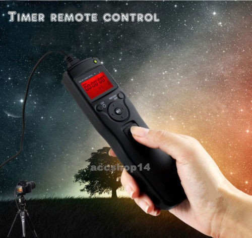

I'm currently using this, its a generic one from Ebay... It'd be great to have this functionality built-in and accessible wirelessly
