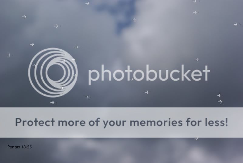

Sooo, my newly acquired (used) K100d Super seems to have some dust on the sensor.
I took a bunch of out-of-focus pictures, with 2 different lenses. The spot remains in all pictures.
There were four of these at first, but after blowing on the sensor with the rocket blower a few times, all went away except this one.
(100% crop)
(as big as the forum software would allow)
Having tested out of focus and with 2 different lenses, I have to conclude that it's on the sensor. But my Mark I eyeballs cannot see a thing on the sensor!
Sorry for the noobishness, but do I just need to persist in trying to get the sensor clean, or could it be something else?
Thanks in advance for the handholding.
07-29-2008, 04:19 PM   #2
Wheatfield's Avatar
Posts: 10,058
QuoteOriginally posted by deuces Quote
Looks that way to me, too.
07-29-2008, 04:24 PM   #3
morfic's Avatar
Join Date: Feb 2008
Location: San Antonio, TX
Posts: 428
Me three. Either get Mk III eyeballs and then send them in for focus adjustments, or blow the thing off.
07-29-2008, 06:27 PM   #4
SpecialK's Avatar
Location: So California
Posts: 14,627
Classic dust. A BIG rocket blower is a good investment. On rare occasions I have used the Eclipse fluid and Pec pads. After that first treatment a year ago(and turning off the camera during lens changes) I did not see any dust for a very long time, though it has subsequently returned now and again.
07-29-2008, 07:43 PM   #5
Location: Buffalo/Rochester, NY
Posts: 1,133
It's inevitable to at some point get dust on your sensor. I once found what what looked like a piece of lint on my photos. I removed the lens and went mirror-up expecting to see it, but I couldn't see much of anything but what seemed like a perfectly clean sensor. I used a large bulb blower I bought just for this purpose and after a thorough blowing, it was clean.

07-30-2008, 04:15 AM   #9
Location: Virginia
Posts: 141
if you want to see how much dust is truly on your sensor you can take a shot with your camera stopped all the way down of your computer screen when set to a solid white background... then open this file in photoshop and then auto level it.. you may be surprised at what you find lol... The only way to truly remove 99.9 percent of dust is using the wet method, its acutally pretty simple and nothing to be scared of as long as you have a clean enviroment to do it in... those sensors will stand up to a lot more than you think... i have done MANY wet cleanings on my k10d's sensor with no problems... i use eclipse fluid, and a kimwipe wrapped around a home made wand made out of a popsicle craft stick... to use the popsicle stick as a wand just clip one of the ends off so its flat... then just a few drops of eclipse on the kimwipe and swab back and forth across your sensor to cover the entire surface... your end result is a sensor thats as clean as the day it came out of the factory, if not cleaner!

07-30-2008, 07:38 AM   #11
Location: Los Angeles
Posts: 6
Is the fluid in the Sensor Scope kit the right kind for the K20D? I read that because of the special coating, a special fluid is needed.
07-30-2008, 08:43 AM   #12
Location: Virginia
Posts: 141
QuoteOriginally posted by Wolf1462 Quote
supposedly your supposed to use E2 with the K10 because of the anti dust coating, but ive always used plain Eclipse fluid.... The stuff literally dries on contact... Ive had no problems what so ever... Ive acutally seen people put "elbow grease into cleaning a sensor, no kidding... scrubbing away lol... no adverse effects... its not really necessary, just with light pressure and swipe back and fourth to cover the entire area and your good to go... it may take 2 tries to get the hang of it but its not hard... nothing to be scared of if you have a clean environment and plan everything out ahead of time. those 200 dollar kits are not worth it and in all honesty there not gonna get 99.9% of dust off the way a wet cleaning will. also, you may feel the sensor move or shift during cleaning, its expected as the anti shake mechanism moves when pressure is applied and it wont hurt anything, so dont freak out if this happens if you decided to swab your sensor lol
