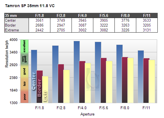

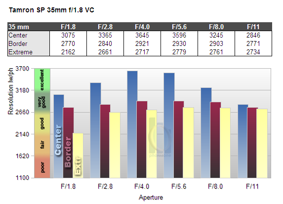

11-30-2020, 07:10 PM - 1 Like   #120
Join Date: May 2009
Location: Somewhere over the rainbow
Posts: 960
QuoteOriginally posted by Serkevan Quote
But if both formats have the same amount of pixels then the pixel density is different, right?
This is correct
---------- Post added 11-30-2020 at 08:27 PM ----------
QuoteOriginally posted by BigMackCam Quote
I should at least see the difference.
It's rather hard to find data as many times we have one camera with a AA filter and the other without
Here is the Tamron SP 35 1.8
here it is on the D7100 at 24mp
And here it is on the D3X at 24mp, and we know this camera has rather strong AA filter
What is interesting to see is that when this lens is shot wide open at f1.8 or even stopped down to F11 that this combo can resolve nearly as much resolution as this lens at its best f-stop a on a dx body
