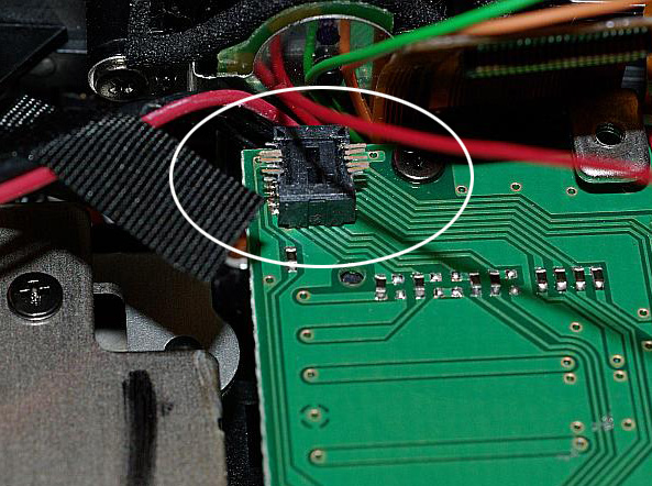

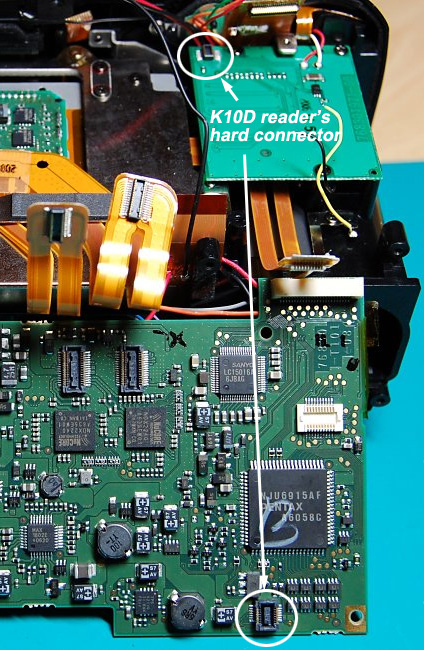

12-27-2008, 11:43 PM   #9
Posts: 13
K10D main PCB and its reader
K10D reader and main-PCB both side has taken a hard connector, it is a bad design way, and K10d is just a half length metallic framework, which it easily cause the serious accidents:

12-29-2008, 10:19 PM   #12
Posts: 13
QuoteOriginally posted by Niemiri Quote
However, nothing helped.
Sorry, I did not help more to you, and the above reply is as an only help of information to you.
It is not a card problem; I bought a new one, and it works in another camera.
I will contact Belgian dealer of Pentax, and try to argue that this should be repaired at their expense.
Yes, which was not a SD card's problem to your K10D.
This is a serious defect at the manufacturer obviously.
