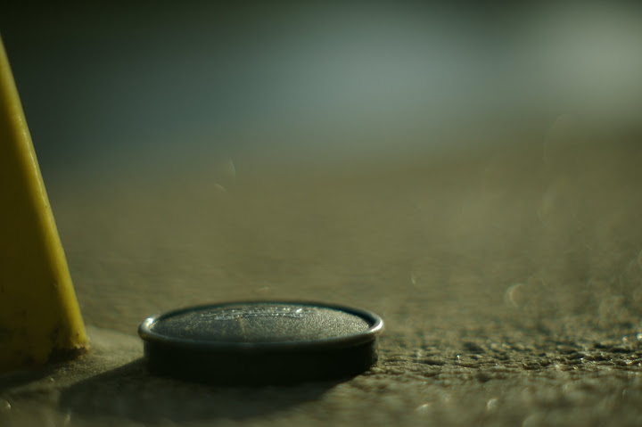

POLL: Who has front-focusing in tungsten lighting?
It honestly bugs me that I get focusing differences in different lighting color temperatures on my K20D. I did some tests with the following conditions:
1. On a tripod for exact scene
2. Largest aperture on lens (DA 70mm f/2.4)
3. One room in tungsten and one room in flourescent lighting
4. 3 shots with no AF adjustment, 3 shots with -9 AF adjustment
5. Before each shot I completely de-focus using the focusing ring
6. Using center AF point
7. Used a target that's parallel to the sensor plane with text for testing legibility
Here are the results:
Tungsten room scene:
No AF adjustment:
With AF adjustment:
Flourescent room scene:
No AF Adjustment:
With AF Adjustment:
I'm using a K20D. Do you get this too?

AF Adjustment can NEVER help you to solve the problem. You can EITHER choose to have AF to focus correctly (in general) under yellow light OR white light. You CAN'T have BOTH!
The achieved focus point by the AF of Pentax DSLRs will always be FRONTER under YELLOW LIGHT! No matter when and where and no wonder!
