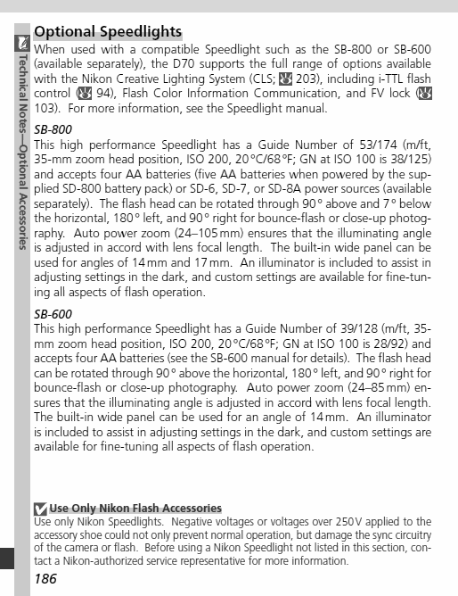

I've done some digging around on other cameras. Canon 20D has a PC sync that is safe up to 250V. Nikon D70 can take 250V even on hot shoe. Same goes for it's successors (D80, D90). It's all written in manuals:
I'm disappointed to see that Pentax hasn't put out any information regarding flash voltages. A camera that can cope with rain, snow and -10°C can get it's hot shoe fried by a feeble old flash
