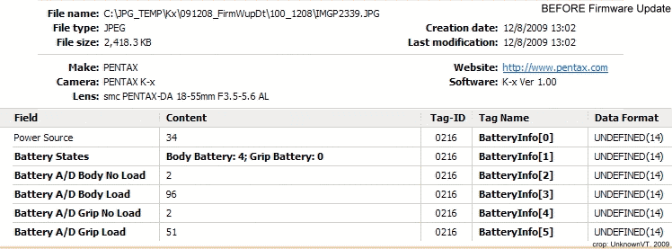

remaining capacity of half Orange eneloops
Just did my Kx Firmware update -
being the cautious type I topped up a set of eneloops
- and took a picture of that, and the SD card I was using, just for evidence....
After the successful update - I replaced the just topped up eneloops with the set that was in the Kx before the update, ie: the set I took my evidence photo with.
I was somewhat surprised that the set of eneloops which showed Green full, now shows half Orange. I did all the usual tricks of turning off, LV, trying battery type NiMH and Auto-Detect and back; and even reinserting that set and waiting a good 15 secs before turning on - but the state remained a consistent half orange.
I had used that set (shot count 381, no flash) but on version 1.00 it would have continued to show full Green -
now with 1.01 it is showing consistently half orange.
This may well be more accurate -
but I thought people would like to know that perhaps version 1.01 may not show full Green as often now.
Here are the PhotoMe extracts of the battery information:
BEFORE Update -
in field Battery States - Body Battery: 4 which I think means Green Full
AFTER Update to 1.01 -
Battery States - Body Battery: 3 = half Orange.
EDIT to ADD -
I discharged that set of eneloops which now show half Orange to see the remaining charge/capacity.
1345; 1333; 1381; 1355 mAh (average = 1353.5mAh)
This means that those eneloops were roughly between 68-71% charged ie: more than 2/3 full - I would have expected to see as Green battery - but they definitely showed a half Orange - and according to the manual this is supposed to mean:
"Batteries are running low" -
over 2/3 full eneloops canNOT be considered as "running low" by any stretch of the imagination as they have really only taken 381 shots at that stage (and I have shown they are capable of nearly 1,300 shots per charge and the ending capacity is more like in the range of 20-40mAh) -
so could there be a possible problem still with battery level indication even in firmware version 1.01?
BEFORE Update -
EDIT to ADD -
Did you have it set in AUTO or NiMH mode?
I had discovered the meter wasn't any more accurate (particularly in AUTO), but the camera certainly lasted longer. One set of batteries in AUTO showed red but lasted for hundreds of shots. My recently charged eneloop show green in NiMH but kodak pre-charged only show orange (even in NiMH iirc).

QuoteOriginally posted by Eruditass Quote
I have my Kx set on NiMH.
While trying out the previous eneloops that were over 2/3 full and showed full Green on firmware 1.00 - but showed half Orange on FW 1.01 -
I switched from NiMH to Auto-Detect (tried that for a while including most of the former "tricks" - but continued to show half Orange) -
switched it back to NiMH (again tried most of the "tricks") those 2/3 full eneloops continued to show half-orange.
Kx was on NiMH when I put in a freshly topped-up charged set of eneloops - and got full Green.
This set of eneloops have now taken 362 shots - and still show full Green - on what I would consider my "normal usage" - a few, but mostly no flash (1 sec review, 1 min power save - no LV or movies; fair amount of, but not excessive reviewing) -
please remember I did manage to achieve just under 1,300 shots on eneloops in FW 1.00 - under similar circumstances (but probably more playing around since the Kx is/was new).
All my eneloops are in v. good condition, and individually id/numbered -
I use a Maha C9000 for analyzing and charging of these.
