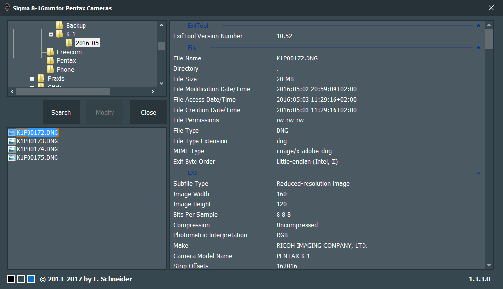

08-22-2016, 01:49 AM   #16
fs999's Avatar
Location: Luxembourg
Posts: 6,127
QuoteOriginally posted by Mike L Quote
I installed version 1.3.0.0 yesterday using the zip file. The PentSig window opens and I can browse to a directory that I know has DNG and JPEG files taken with an 8-16mm lens at 8mm and 9mm but when I click search nothing happens. I don't even get a notification that no results were found. Any advice?
Normally it should be version 1.3.1.0 exe stamp : 18/08/2016 10:55:20

08-23-2016, 01:07 AM   #19
Join Date: Oct 2007
Location: Canberra, Australia
Posts: 1,960
QuoteOriginally posted by fs999 Quote
I have re-uploaded the PentSig.7z. You can see if it works now.
I've tried it again and I'm afraid it is still the same for me. The search button doesn't start the search.

08-23-2016, 10:37 AM   #20
fs999's Avatar
Posts: 6,127
The directory is empty !
08-23-2016, 04:36 PM   #21
Join Date: Oct 2007
Posts: 1,960
The directory has over 1,500 files in it including many that are taken with a Sigma 8-16mm at 8 or 9mm
08-24-2016, 02:10 AM   #22
fs999's Avatar
Posts: 6,127
But on your image, the list under the search button is empty, so the program can't search in the files...
There is perhaps a security conflict, so that the program can't see the files...
The program is looking for *.DNG,*.PEF and *.JPG files.
08-24-2016, 04:08 AM   #23
Join Date: Oct 2007
Posts: 1,960
Here is a screenshot showing the files in the directory PentSig is pointed to. You can see there are many .DNG and .JPG files in the directory but the PentSig window doesn't show anything.
08-24-2016, 10:39 AM   #24
fs999's Avatar
Posts: 6,127
Oh I see. I think it is because the extensions are hidden, so when I get the filename, there is no extension.
What you have to do is, in Windows Explorer, click on Tools menu and click on Options. In the dialog change to Display page and uncheck the "Hide the known extensions (or something like that)" item.
This will show the files in the listbox.
08-24-2016, 03:33 PM   #25
Join Date: Oct 2007
Posts: 1,960
That seems to have done the trick - the files have been found and modified now. Thanks for your assistance.

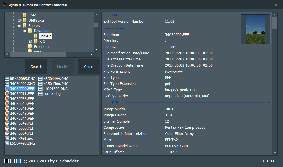

A new Version 1.4.0 (27/06/2018)
  • Image preview
