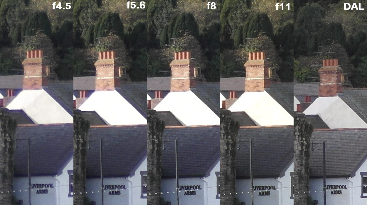

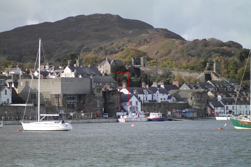

Like pericombobulation I have compared this lens side by side with the DAL 55-300mm. Unlike him however my results favour the DAL. Test pics Samsung NX20, mf by eye with 7x evf magnification, jpg's.
At 100mm purpling and halo/coma was very evident wide open, where the sunlight was reflecting off eg whitewashed buildings. There was fringing on the skyline as well, in the form of a seepage of purpling into the dark edge. Stopping down ameliorated the CA but it was still discernible at f8 on the skyline at 200% on screen. Resolution was actually broadly quite close to that of the DAL at ~ 90mm f4 (I set at ~100mm but pic is evidently at a slightly shorter focal length, obviously the samsung doesn't record actual focal length) , and pretty consistent, I didn't notice great improvement stopping down. IQ was also consistent across the frame on the APSC cameras used (in fact distinctly more so than the DAL which was a bit softer right edge). Colours and contrast put out by the NX's internal jpg processing were similar. Results at 135mm showed slightly better resolution but were mostly similar, and I wouldn't say the 100-300mm has any significant IQ fall off going right to its 100mm zoom range limit.
If it wasn't for the CA issues the F would actually be competitive with the DAL at 100mm. Comparing the crops between the DAL and F is slightly misleading because the sun went behind a cloud, reducing the contrast on the foliage and the glare off the buildings to the detriment of the former and improvement of the latter, but the impression that the F has resolved most things pretty much as well as the DAL is correct.

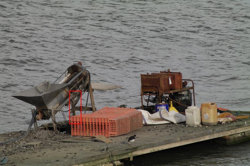

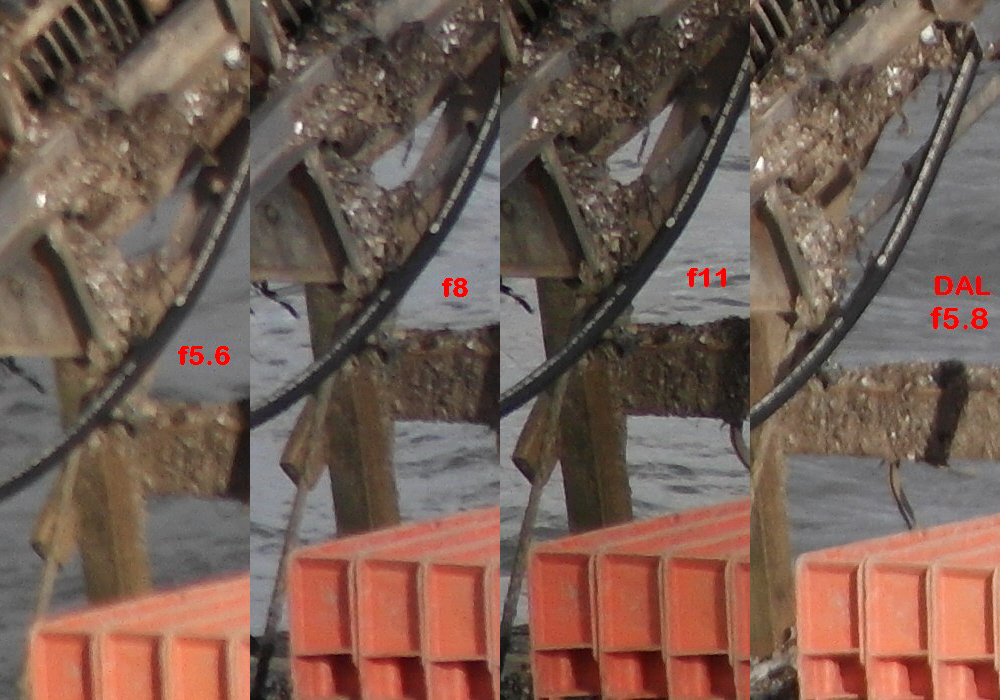

Full size 1:1 crops.
Results at 300mm showed the F as much softer than the DAL, the F would only start being competitive with the DAL once stopped well down. Some reviewers have suggested that the performance drops noticeably zooming towards 300mm, however I didn't notice that resolution significantly improved backing off from 300mm to ~250mm, maybe a touch. I would simply concur that resolution at the long end just isn't that good; CA however is much improved over the results at 100mm . Wide open was particularly soft, much softer relatively than wide open at the other end of the zoom range. I was only happy with bird test pics results when stopped down, all the wide open shots were disappointing for me.

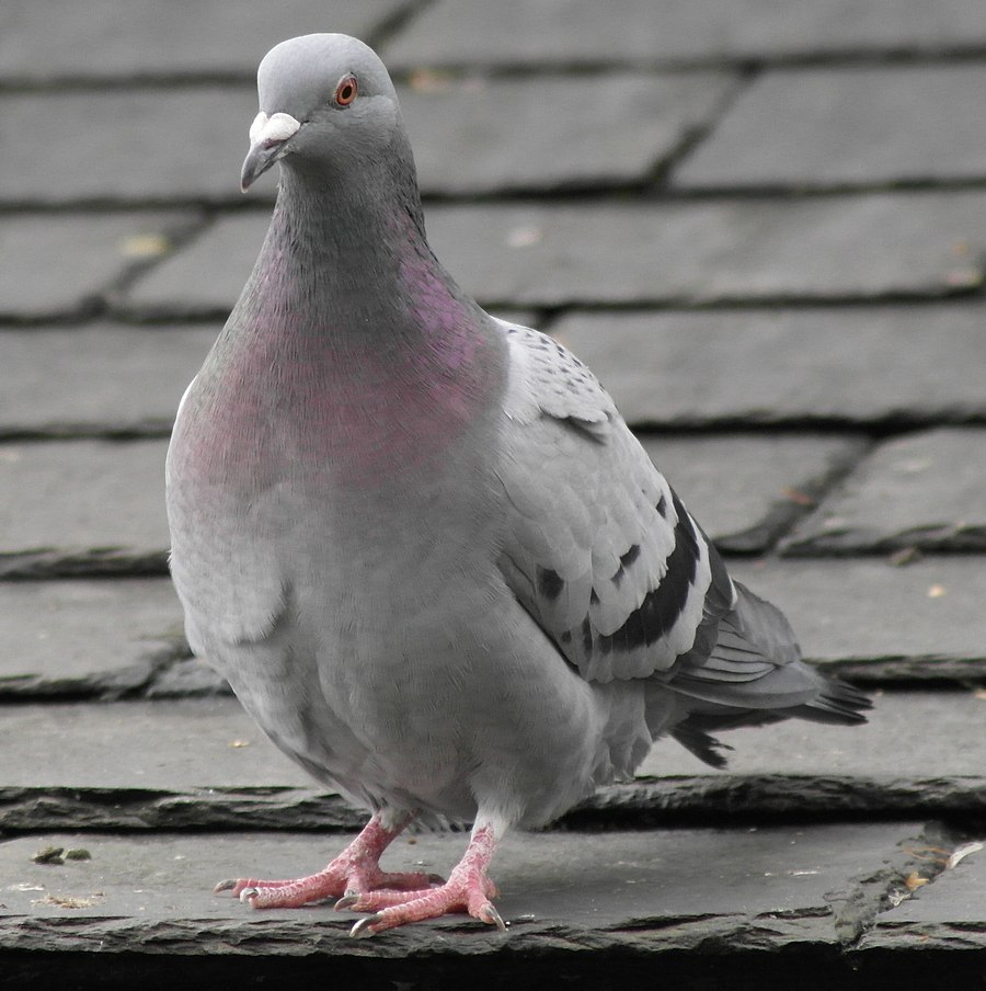

Overall I would have to say the IQ just doesn't quite do it for me, specifically at the 300mm end, not with a DAL 55-300mm in hand. I would like to ask pericombobulation whether he used just AF or checked things with MF and eg live view. It is possible that he has a particularly good F 100-300mm/poor DAL 55-300mm. But in any case if you're looking for a cheap x-300mm zoom option this can do (if you get a good one, reviews of SMC-F series lenses suggest inherent variability).
A pigeon at 300mm f10, samsung NX20.
